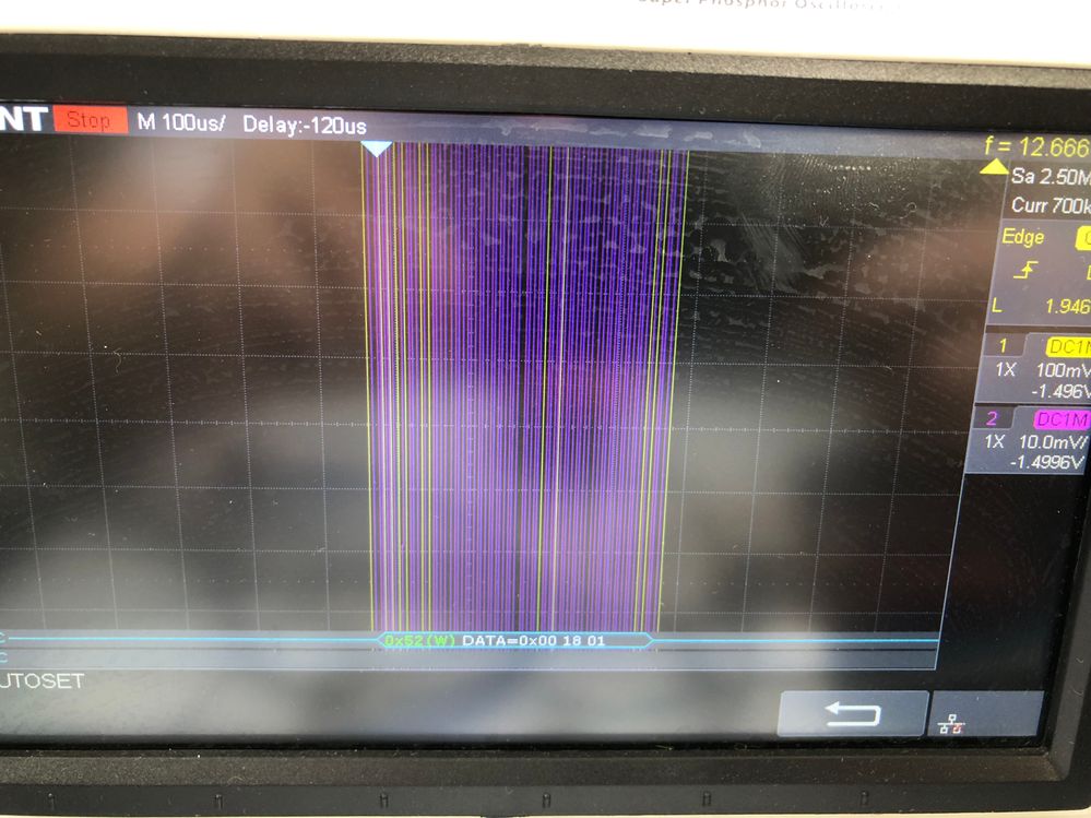

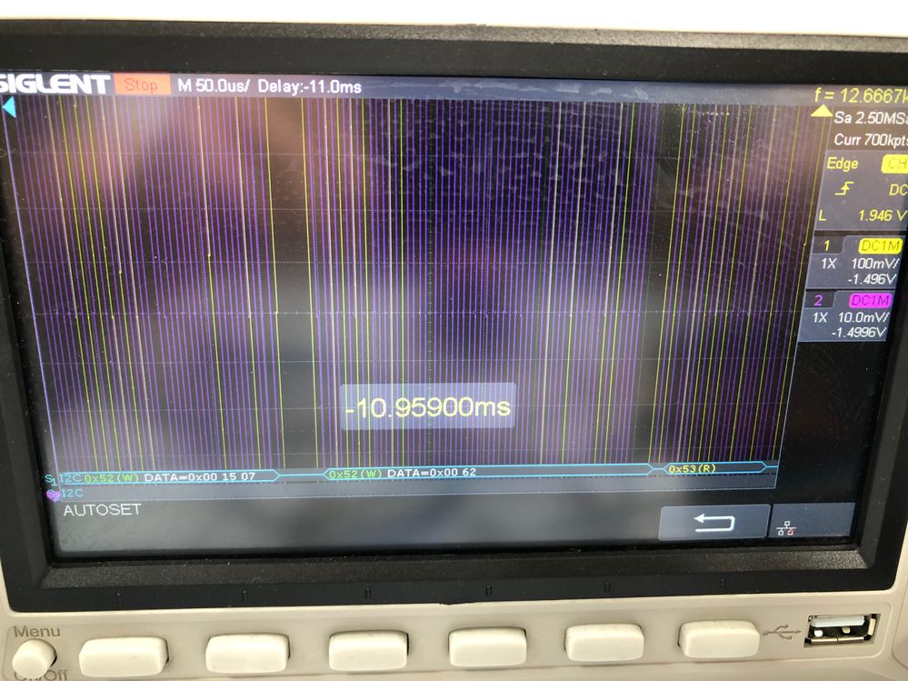

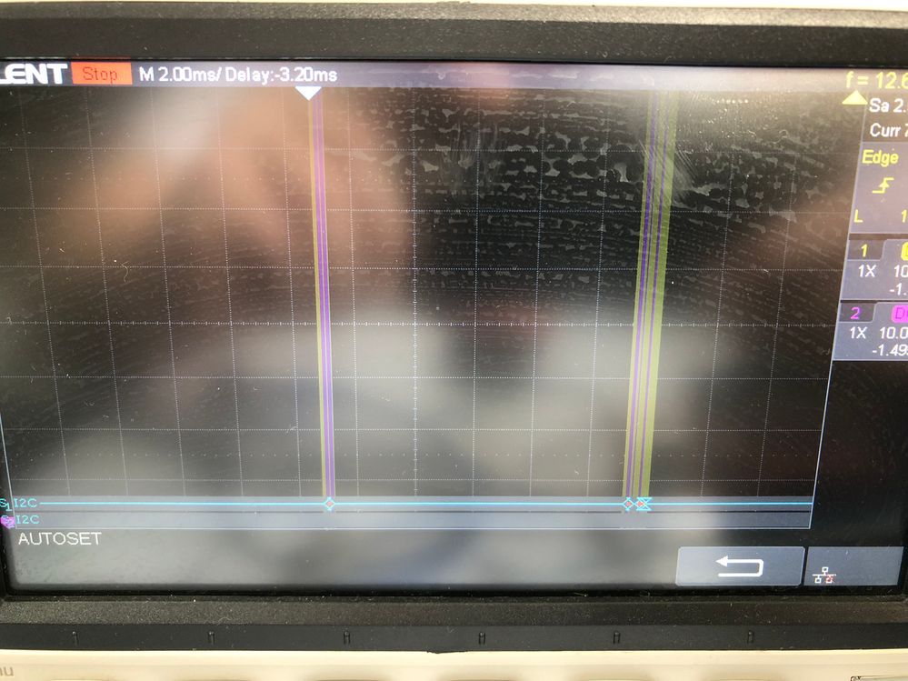

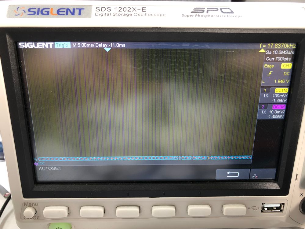

Yes my scope has I2C decode and when I look at it, I see what problem is. There is a definetely read problem.
For example:
i2c_start();
i2c_write(VL6180_address); // 0x52
i2c_write((0x0018 >> 8 ) & 0xFF);
i2c_write(0x0018 >> & 0xFF);
i2c_write(0x01);
i2c_stop();
delay_ms(10);
i2c_start();
i2c_write((0x0015 >> 8 ) & 0xFF);
i2c_write(0x0015 >> & 0xFF);
i2c_write(0x07);
i2c_stop();
i2c_start();
i2c_write((0x0062 >> 8 ) & 0xFF);
i2c_write(0x0062 >> & 0xFF);
i2c_stop();
i2c_start();
i2c_write(VL6180_address + 1); //0x53
sensor_data = i2c_read();
i2c_stop();
delay_ms(500);
Now I will show you 4 scope photos.
If I do not use the "i2c_read()" command you see on line 24 in the code above, the messages appear as in the first 3 images. Everything seems in order.
If I use the "i2c_read()" command, things get crazy like in the 4th picture. Picture 1Picture 1picture 2picture 2picture 3picture 3picture 4picture 4
