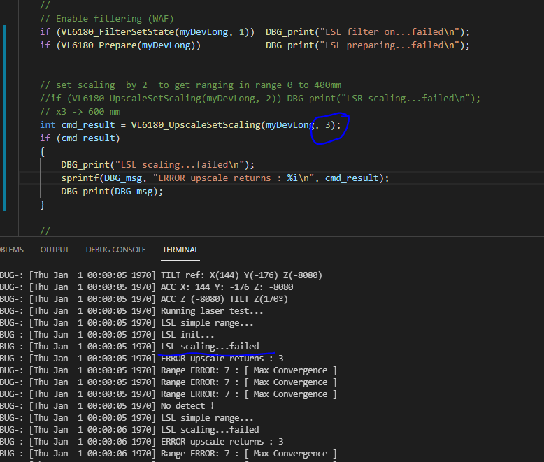

I have tried to use x3 upscaling, but error is returned when doing so by:
VL6180Dev_t    myDevLong;
VL6180_UpscaleSetScaling(myDevLong, 3);

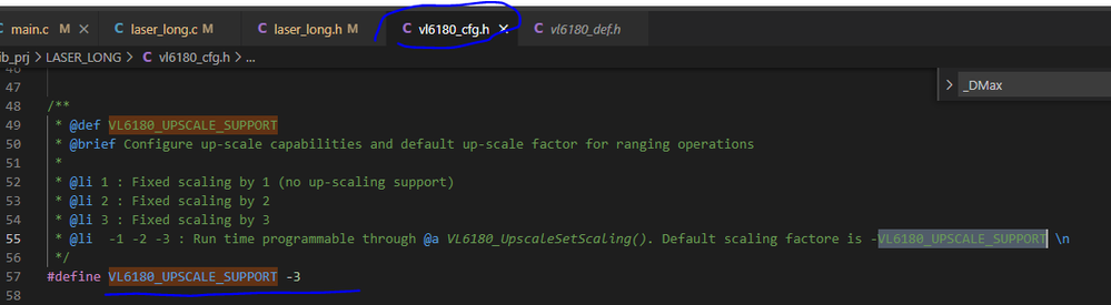

It seems as upScaling it is not allowed, but it is enabled in vl6180_cfg.h:
Can you please advice if I am doing anything wrong.
Regards, Ramon.

Jhern.1
Hi John,
Thanks for your answer.
I understand what you say, but I am not sure what is going on with th upscaling.
Note the Upscaling is giving me an error ¿Is this normal?
0693W00000JMApKQAX.pngBy the way, I have tried larger surfaces. In spite of detecting further objects it can not detect futher than 350mm.
Regards, Ramon.
John E KVAM
the up-scaling is not giving you the error. Upscaling only occurs because the chip designers use an 8-bit byte to return the distance, never imagining anyone would want to range beyond 255mm. But it clearly works farther than that. So upscaling is simply dividing the range result by 2 (or 3) and retuning that value - then multiplying the result back up on the MCU end.
It's still the lack of photons that is giving you that error. The Max convergence says that you did not get enough photons before the timer ran out. You can increase your Max Convergence time and allow the sensor to gather more photons. Or use a mirror (or other really bright target) to reflect more photons.

Jhern.1
Hi John,
Thanks for your detailed answer.
I understand the range error is due to lack of photons back. I will try increasing convergence time.
I was trying to understand why the upScaling function is not returning 0 when set to x2 or x3. It returns 3 instead.
