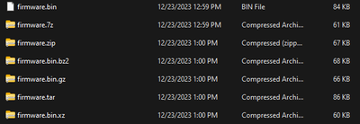

Mostafa1
Thanks for your replies,
I have tested emCompress tool and here are the results:
emCompress-ToGo Compression Utility V3.32a compiled Jun  7 2022 14:50:43
Copyright (c) 2015-2019 SEGGER Microcontroller GmbH    www.segger.com
Statistics:
  Original:     86016 bytes
  Compressed:   72630 bytes, or 84.44% of original
  Saving:       13386 bytes, or 15.56% of original
  Standardized: 6.76 bits/byte
So basically it went down from 84KB to 70.9KB.
I have also tested 7zip on Windows and got better results, around 60KB (not sure about the complexity to be decompressed on an STM)
