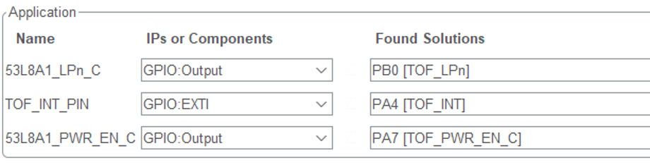

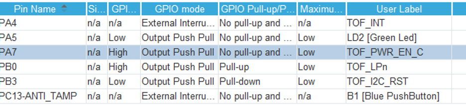

I have a P-NUCLEO-53L8A1 development kit, which consists of an X-NUCLEO-53L8A1 connected to NUCLEO-F401RE. When I am using the GUI program STSW-IMG041, it can correctly get data. However, I am using the X-CUBE-TOF1 kit from this website link: https://www.st.com/en/ecosystems/x-cube-tof1.html. I compiled the example '53L8A1_SimpleRanging' located in 'en.X-CUBE-TOF1\Projects\NUCLEO-F401RE\Examples\53L8A1', but I encountered an error while running it: 'VL53L8A1_RANGING_SENSOR_Init failed. Check you're using ONLY the center device soldered on the shield, NO satellite shall be connected!' I debugged my code and found that it fails when trying to read the ID:
if (VL53L8CX_ReadID(&(VL53L8CXObj[Instance]), &id) != VL53L8CX_OK)
ret = BSP_ERROR_COMPONENT_FAILURE;
Since using the GUI program gives me data successfully, I believe the module itself should be fine. However, I can't initialize it using the code.
I look forward to receiving help from all the experts. Thank you very much.
Best answer by John E KVAM
i had this issue. I tracked it to a mis-configured I2C. When I added the TOF software to the STM32_CubeMX, I realized the software knew nothing about the hardware configuration. Granted the CubeMX won't let you generate code if you have not assigned the pins, but there is no safeguard if you have them wrong. I ended up with the Nucleo board schematics and the schematic for the X-Nucleo53L8A1, and just tracing out the lines. (As a software guy - it was an enlighening experience.)
But based on my sample set of one, I'd double check the pin assignments.
If the EVAL GUI software works, you know your board works. So I'd not go there.

Hi, I am working on the same board and same application and I am getting the same error. I am very new to this and not very proficient. I was wondering if you could share the the pinout config so simple ranging on the X-NUCLEO-VL5L8A1 ?
Any help from your side is greatly appreciated.

John E KVAM
John E KVAMBest answer
December 20, 2023
- john
