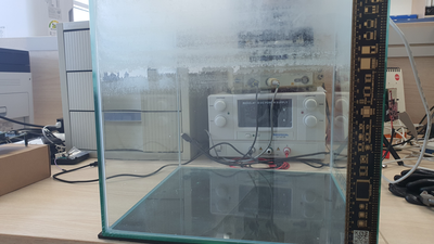

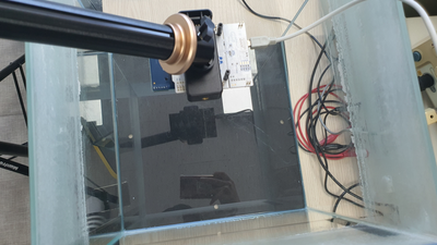

The test container and environment are shown below. (I placed a black object on the bottom of the container to lower the floor reflectivity)

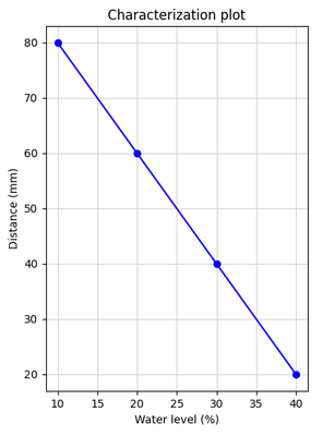

Referring to page 3 of STSW-IMG039-L4CD.pdf, when the indicators was set to 5, 4 measurement levels (10, 20, 30, 40%) were created, but the distance values of the characterization plot did not match. Therefore, the indicator of config.txt was set to 10 and proceeded. (ex, if the total height is 200, the distance of 10% should be 180)

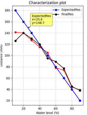

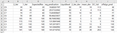

The measured characterzation is shown below.
I think it's clearly mis-measured.
