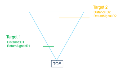

Would it be possible to use a Time-of-flight sensor to measure water level in a pipe?
The pipe is vertical with a diameter of 50 or 75 mm and a height  of 800 mm. At bottom there is a 90 degree bend. Sensor should be at top looking down the pipe. I assume that best sensor would be VL53L4CD since it has smallest field of view. Would reflection from pipe walls disturb measurements?

VL53L4CD measure the distance by Sigma Delta method. overall, the reported distance= (D1*R1+D2*R2)/(R1+R2)
But with VL53L4CX histogram. In theory, most photons will be reflected back by the water surface and received by SPADS, unless there is an object with a very high reflectivity at the bottom of the water in pure water, which maybe distinguish between the water surface and the bottom. You can have a try and play VL53L4CX to verify.
About the VSCEL and beam parts are confidential and not convenient to share. Really sorry for that. However, if it is a specific project, you can contact our FAE and get the answer. Thank you

Thank you for the additional application details. Based on your geometry and the principles AN5851 described in for liquid level sensing.
A VL53L4CD can be evaluated for this application, but the main challenge is indeed pipe wall reflections, especially in a narrow pipe with a long top-down measurement path.
In the chapter 2.1 of AN5851 , the ToF sensor FoV is conical, so the container geometry has a direct impact on the measurement. FoV is approximately 18°, So the beam expands with distance. The footprint diameter can be roughly estimated as D2h*tan (9°).
If your decision point is about 200~300mm above the bottom, with a total pipe height of about 800mm, then the sensor-to-surface distance is roughly 500~600mm. we can get the diameter D is 158.5~190.2mm.
At that distance, the beam footprint becomes much larger than a 50~75mm pipe diameter, so part of the light will inevitably hit the pipe walls. Therefore, the optical situation is intrinsically one of *mixed returns*, not direct clean liquid-surface ranging.
your requirement is only to detect whether the level has crossed a fixed threshold, for example around 200~300mm from the bottom, so this application is better positioned as threshold detection rather than continuous level gauge.

Thank you very much for your detailed answer. I have located some more info about your sensors, but it is not so easy to find it. From what I understand the VL53L4CD or VL53L4CX would be most suitable. I suspect there can be a situation where there is one return from water level and one from the bottom. Would the VL53L4CD only respond with the distance to the largest return? With the VL53L4CX histogram, I suppose that I can see both bottom and water level and maybe also have a zero histogram as reference and then compare measurements with the reference and look for deviations.
