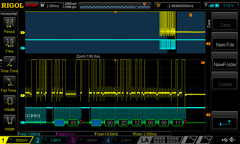

When connected to a Raspberry Pi 4B, the rangefinder seems to get confused and ACK when it shouldn't. I have tried this with three different Pi's and two different rangefinders, everything I had in stock this week. Both rangefinders were recently purchased from Mouser. The setup is as simply breadboarded as I can get, with ~1k8 pullup resistors; I have pix but since I only get three uploads for this post I'll save it for the comments. The behavior is inconsistent, but almost always I2C communication fails during initialization of the rangefinder (though I have twice gotten a single measurement from it). Below is an example of what I'm seeing:
Fig. 1: Failed rangefinder initialization. Yellow: SDA, Cyan: SCL

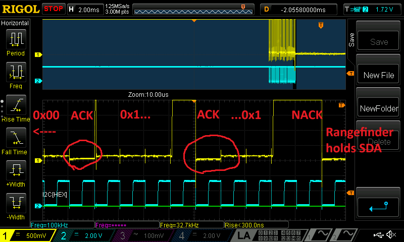

Fig. 2: Premature ACK and rangefinder holding SDA low. Yellow: SDA, Cyan: SCL
As in the captions, the yellow trace is SDA and cyan is SCL. The current CircuitPython instruction being executed is line 194, `self._write_register(0x002D, init_seq)`. You can see that in the decoded section of Fig. 1, where the Pi has written to register 0x002D bytes 0x12, 0x00, 0x00, 0x11 from the initialization sequence.
As far as I can tell, the slightly lower SDA voltage is the rangefinder pulling down to write to the bus or ACK, which is the basis of my suspicion for premature ACKing. As you can see in the second figure, the previous byte 0x00 was ACK'd successfully and the Pi moves to sending the next byte. On the fifth bit, the rangefinder ACKs again (which will clobber a 1 if the Pi was trying to write, which is what tipped me off to this problem in the first place) and is now out of sync with the byte-stream. The Pi interprets the rangefinder's silence as a NACK and releases SDA, but sometimes (as shown above) the rangefinder then takes SDA and holds it low until I power cycle it.

Thomas - I rarely see a post with as much data as yours, well done there.
I've used I2C almost since it was invented. And yours is a very common problem. A small glitch on the clock line, and the 'master' and 'slave' get out of sync. (Really should change those terms - how about MCU and sensor instead?)
You end up with the clock or data line held low. The 'bus stuck low' is so common that TI wrote a paper on the issue.
But there are lots of others.
I'm going to blame it on your level shifter. Because it's always the level shifter. I hate those things.
The IOVDD on the VL53L4 has a max of 3v5 and if your RPi is 3v3 I can see why you have designed one in.
As a test, could you bypass it? Or switch to a different kind?
Another common I2C issue is line length. I've found a foot is about as long as anyone should run an i2C.
But as you have stated, it's those short spikes that are killing you. You have to get rid of them somehow.
I'd suggest a small cap - if you aren't trying to run you I2C at the fastest rate. That might just fix you up.

Thanks very much, @John E KVAM. I added 10 pF capacitance to SCL and now it takes on the order of minutes before the rangefinder clock de-syncs instead of ~100 us (EDIT: having upped to 47 pF, it's been running for half an hour without issue). That's very much workable. Now that you jogged my memory, there was a difference between the flight model and the replica I just built; I was too lazy to include shielding on the replica's wire bundles, which I suspect would have added a non-negligible amount of parasitic capacitance. :facepalm:
I'm going to go ahead and call this resolved! I'm sorry that this forum is 90-odd percent troubleshooting communication bus issues, but I really appreciate you taking the time to do it anyway. For posterity, I'll clarify a couple more details about my setup that you brought up:

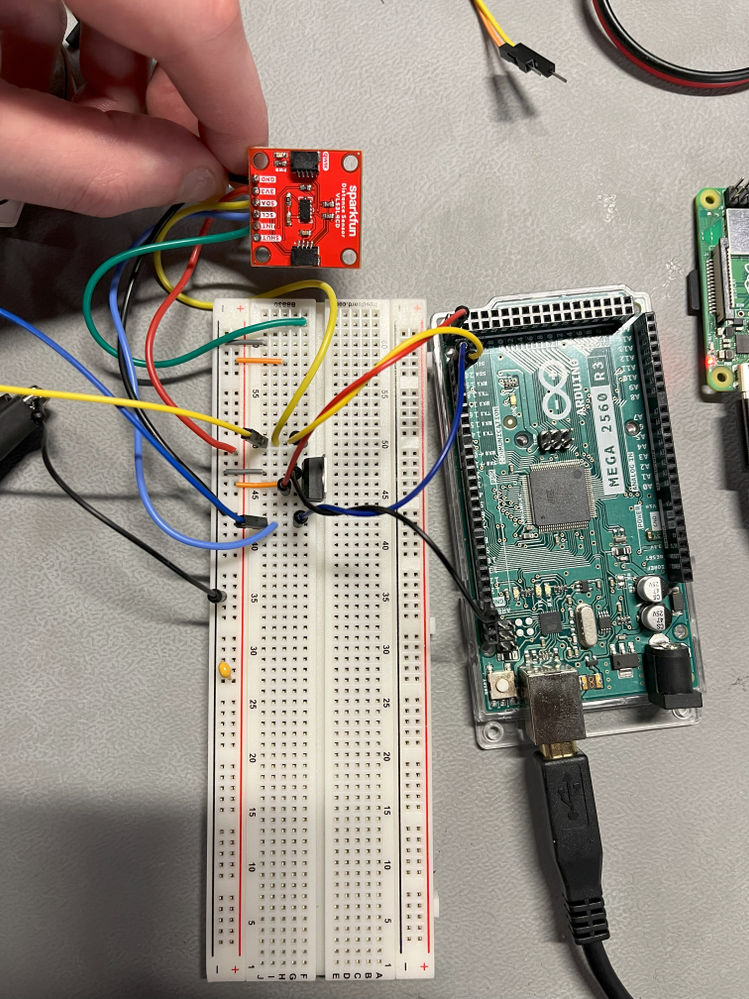

- I removed the address translator/level shifter from the test setup not long after I started trying to solve the problem, for the sake of simplicity. I've included a picture below of my test setup with the Arduino (not pictured: additional 1k2 pull-up resistors). Per your suggestion in a previous post I had twisted SCL and GND together.
- Wire lengths for both test setup and the replica model were approaching 1 ft so I'm definitely on the edge of what is doable for I2C. A good learning experience, for sure.
Fig. 1: Test setup with Arduino
