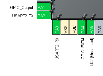

Julien NGUYEN
Hi Sid, Could you please send me a picture of the connection you did between the VL53L3CX-SATEL and the Nucleo-F401RE ?
Have you connected the XSHUT pin to the PA1 and the GPIO1 pin to the PA4 as shown below ? Julien

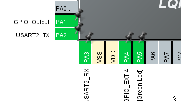

@Julien NGUYEN​ Excuse my delayed response, the forum does not send me a notification when a new post is made. Is there a setting for that?
My hookup looks the same as yours.
