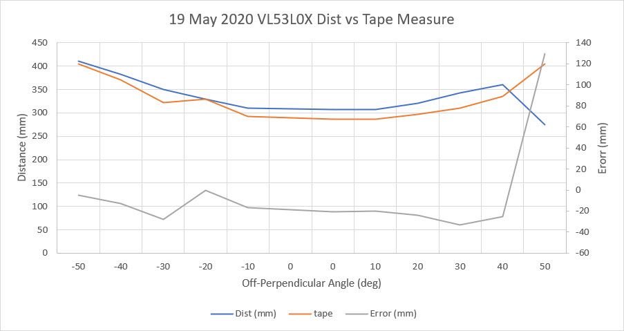

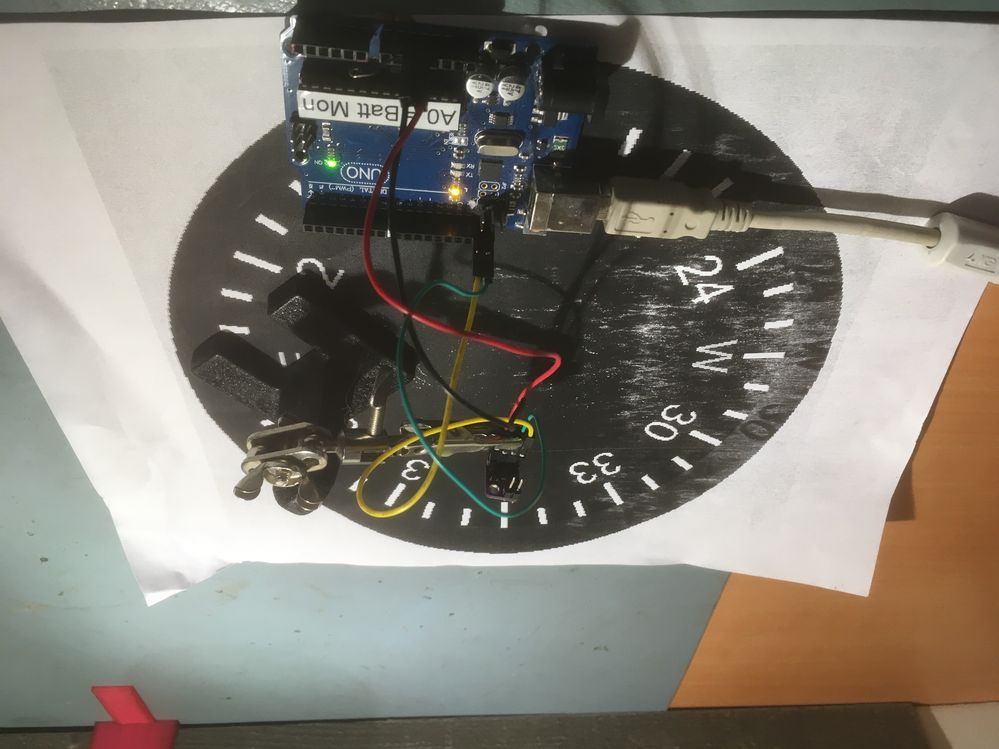

I'm using the VL35L0X.ino demo code on an Arduino UNO and a clone VL53L0X sensor. I very carefully measured the off-perpendicular distance measurements obtained from the VL53L0X and compared them to actual tape measure measurements. On average there was about 20mm difference between the two.
Also, the VL53L0X gets a little flaky more than 20-30 deg off perpendicular, reporting a '20' about every 3-4 measurement, making it a bit dubious for real-time measurements unless a 5-10 pt average is taken. Granted, the measurements were being done at 1 measurment per second so I would have plenty of time to average, but...

The light goes out as a cone of 27 degrees. So the diameter of the cone at the target is equal to 0.44 times the distance to the target. So call it half.
the sensor 'averages' all the photons it gets back. So one might assume that as the target rotates from perpendicular the average will remain the same.
But it doesn't always work like that. If your target is at all 'mirror-like' (Specular) the photons will bounce away and never return. So one has to keep that in mind.
Can you also examine the signal rate. As the photons bounce away the signal rate goes down and if low enough creates error.
I also notice that at 0 degrees your error is 1cm. Can you look into doing an offset calibration before starting the experiment. I think that will solve that issue at least.
I really cannot tell from your picture, but at 40 degrees (where your error goes crazy) is the cone of illumination still fully on your target?
Increasing the timing budget (amount of time for each measurement) should help. 4x the time = 2x the accuracy.
It will at least reduce the jitter.
Great experiment.

The backdrop for the experiment was a textured wood plank, so not very specular. Earlier I had tried a piece of foam-core with a shiny white finish, and that didn't work as well - I suspect the 'lost photon' phenomenon was the culprit there.
No, I'm not sure the 27 degree beam was fully on the backdrop at the far edge of the experiment, so I suspect that was the problem there.
I'm sure an offset calibration would remove the constant offset, but I didn't see anything in my brief perusal of the datasheet and available code about doing such a calibration. I would assume I would just have to set the sensor up at a known offset, read the value, and then do a manual correction in my code. Is there a better way to do it? Unfortunately, in my intended application, manual offset correction will not be possible as I won't have a known starting offset condition.
In this initial experiment, I just used all default settings, just to see if I could get it to work. I haven't played with extending the timing budget, but that's next on my (ever-growing) list of things to do ;-).
