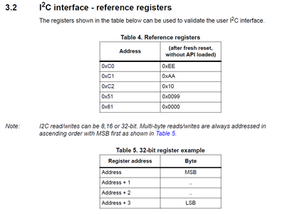

I'm trying to port the VL53L0X library for use with the RP Pico W for academic reasons, but I can't map the calls between the VL53L0X SDK and the RP Pico W SDK.
For example, the function
int32_t VL53L0X_read_multi(uint8_t address, uint8_t index, uint8_t *pdata, int32_t count)
would theoretically need to be adjusted to call the function
int i2c_read_blocking(i2c_inst_t *i2c, uint8_t addr, uint8_t *dst, size_t len, bool nostop)
Attempt to read specified number of bytes from address, blocking.
Am I right? Or should it be another way?

Hi
Your understanding is correct, inside VL53L0X some API I2C read/write function need read more than 4 registers at same time, so it need read_multi and wirte_multi function.
You can find below information form the datasheet, below reg can be used to test the I2C reading function.
Br
Zhiyuan.Han

Hi
Glad to know you have made it works from your side.
The API porting work is more relay on the platform I2C read and write functions. if you have a mature one form on line search, that will easy your work.
Br
Zhiyuan.Han
I found this path easier. Using the library offered by STM seemed quite complete, but I was having difficulty porting it even though I only had to replace the I2C calls. But now that I'm more experienced with the landing process, I'm reviewing the original.
