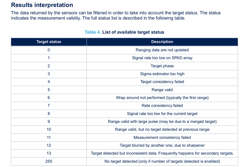

ahsrabrifat
Senior II
Only use the distance value when target_status == 0. ( Edit - Should be 5, not 0 - John Kvam)

Hallo @ahsrabrifat ,
Thanks for your help but i am not sure this would help me. Then in one Documentation you can be read this  : Screenshot from 2025-04-23 18-20-10.png
RogerM
As John says for now just look at zones which have status == 5.
With regards the range data you are printing out.... in the platform.h file do you have the following line active or commented out?
      #define VL53LMZ_USE_RAW_FORMAT
If this is present the driver returns the raw range value which includes 2 fractional bits ...which means the raw value must be divided by 4 to get the actual range in mm.
Please look at the code within vl53lmz_get_ranging_data() which is conditional on the VL53LMZ_USE_RAW_FORMAT define.   Depending on if this is defined or not it either does, or does not,  convert from "raw" to real values.
The above post is incorrect .... target_status == 0 actually means the the data IS NOT VALID and should be ignored.

RogerM
Both the CNH data and the ranging data for each frame are derived (independently) from the same underlying (raw) histogram data that the ToF ranging core collects during integration.  So in that sense that are linked.
There is no type of valid / not-valid check for histogram data. If an illegal CNH configuration is detected by the sensor it should refuse to start ranging.  For instance if you request a CNH configuration which would require more memory on the the device than is available (e.g. you ignore the result of vl53lmz_cnh_calc_required_memory() )  it will refuse to start ranging.
Hope this clarifies things a bit.
