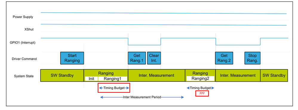

I am trying to get consecutive measurements from the VL53L1X sensor but the timing budget is only kept on the first measurement with the below code
VL53L1X_BootState(dev, &sensorState);
VL53L1X_SensorInit(dev);
VL53L1X_SetDistanceMode(dev, 2);
VL53L1X_SetTimingBudgetInMs(dev, 500);
VL53L1X_SetInterMeasurementInMs(dev, 500);
VL53L1X_StartRanging(dev);
    while (count<5) {
        count++;
        dataReady = 0;
        while (!dataReady) {
           VL53L1X_CheckForDataReady(dev, &dataReady);
            Delay(2);
        VL53L1X_GetRangeStatus(dev, &status);
        aLidarCurrValueValid = !VL53L1X_GetDistance(dev, &aLidarCurrValue);
    VL53L1X_StopRanging(dev);
So in the first measurement the timing budget is kept but in the consecutive ones the dataready byte is instantly 0 which seems to be wrong.
What am I doing wrong?
thanks

I think you need a 'clear_interrupt' call. Even if you don't use interrupts, you need that call to tell the sensor that you have the data and are ready to go again.
VL53L1X_ERROR VL53L1X_ClearInterrupt(VL53L1_Dev_t dev)

The sensor hangs at the second while(count<5) iteration (sensor measurement) with dataready being 0 indefinitely.
BTW all function calls return 0 as they should.
thanks
John E KVAM
Try clearing the interrupt immediately after issuing the start command. I seem to remember an issue where the clears and the readys get out of sync. The sensor apparently starts with an interrupt on. And that's causing you an issue.

The sensor now gets stuck at the second iteration again.
So basically whenever I clear the interrupt the sensor gets stuck.
I have made it work by starting and then stopping the ranging to get a single measurement (EDIT the timing budget is still not being kept by starting-stopping for one measurement) but I'd like to do it the continuous way.

When the Start command is given the VCSEL flashes once and the interrupt line goes high.
Then when I clear the interrupt the interrupt line goes low and never high again.
If I use the Start-Stop technique for a single measurement and clear the interrupt, the timing budget is being kept and the interrupt line goes low upon clearing and then high when I Start ranging again. If I don't clear it, the timing budget is not kept the second measurement on.
