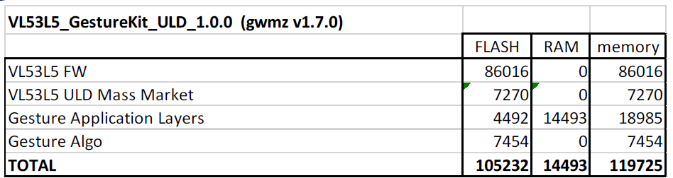

Hi all,
i'd like to know the typical resource requirements (mainly required computing power / DMIPS value) of running the TouchLessControl library (STSW-035) library on a host MCU.
The GestureEVK-UM.pf mentions a typical RAM and FLASH footprint :
0693W00000Sw5bFQAR.pngI know that the library is also availble for Cortex-M0...
But I can not find maximum usage of (D)MIPS, required to run the STSW-035 SW stack.
Even if its may hard to give an exact value due to mapping of DMIPS to real world algorithms -  There are interrupts, DMA, peripherals, RTOS, .... - an indicative DMIPS range would be quite helpful.

That's a tricky one to answer.
But the biggest expenditure of time is the I2C traffic. You will need to tranfer 64 16-bit distances, 64 32-bit signal strenghts, 64 8-bit target numbers and 64 8-bit status values. And there are 15 of these per second.
So keep that in mind.
But rather than give you a number I want to give you some code.
Figure out where you want to measure and add the code.
If you use the STSW-IMG035_F401 it runs at 84MHz,
I know I'm making you do the work. But everyone should know this trick.
  • john
Just add these defines in your code and then the functions.  Simply call the stopwatch_reset to both enable the counter and it resets it to 0.  Then do the stopwatch_getticks to get the current value.  I also add in my watch expressions the *0xE0001004, so if I put in a break point, I can see the current value of the counter.
