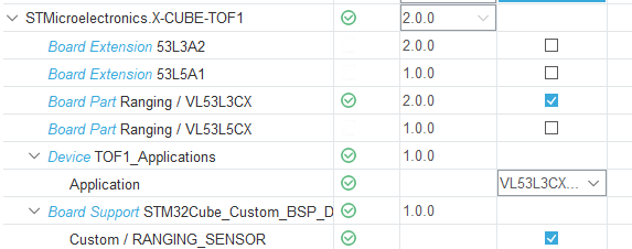

I am trying to explore X-CUBE-TOF1 and I have several VL53L3CX breakout boards. I'm using the latest CubeMX and IDE (6.3.0 and 1.7, respectively) and therefor downloaded both the 2.0.0 and 1.0.0 X-CUBE-TOF1 cube modules.
I've selected the following software packs:

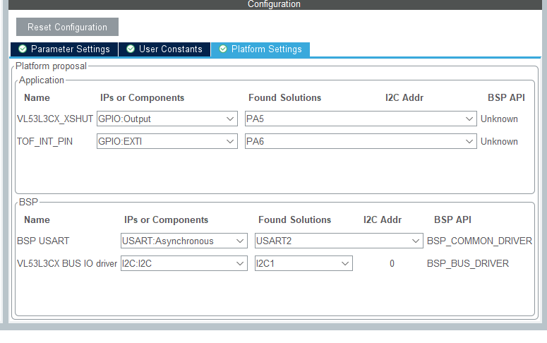

0693W00000D2CIIQA3.pngThe performed the following configurations:

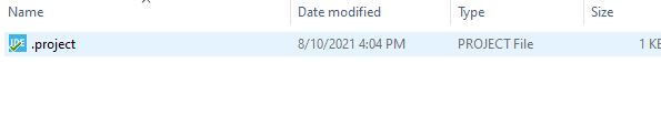

After generating the code, the directory is completely empty.
0693W00000D2CISQA3.pngRemoving the software pack results in a properly generated project (but without the software packs, obviously)

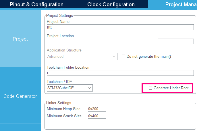

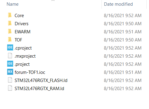

After checking your ioc received by private message , I confirm there is an issue when generating project using STM32CubeIDE as toolchain.
This issue is already raised internally and the recommendation is to generate project with "Under Root" option(ideally from scratch).
The project will be generated correctly under the main project folder.
0693W00000Dpf8UQAR.pngHope this helps you.
If your question is answered, please close this topic by choosing Select as Best. This will help other users find that answer faster.

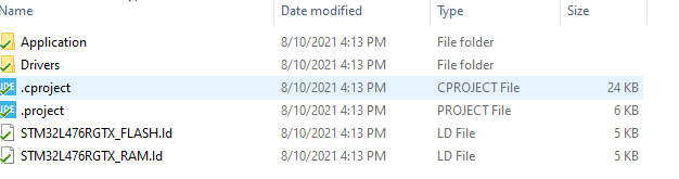

Using CubeMX 6.3.0 and CubeIDE 1.7 I'm not able to reproduce this issue , may be I miss something in your scenario .
0693W00000D2YxNQAV.pngCan you please send me your ioc to check?

Perfect, thank you for the response! I should be able to move the project where I want after that.
I appreciate the time you took to find this answer.
