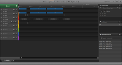

I have purchased SATEL-VL53L8 package containing 2 breakout boards with VL53L8 ToF ranging sensor, and I encountered a peculiar hardware issue. A breakout board has been connected to an ESP32 dev board (3.3V logic level). I have been trying to get it working using SPI bus + ULD driver. When I call the vl53l8cx_is_alive function, a sequence of 4 SPI transactions is executed in order to confirm the presence of the chip on the SPI bus. I connected the logic analyzer to observe the SPI, and on the first glance everything looks fine:
However, the MCU always reads 0s on the MISO line. I have measured voltages on the PCB, and it turns out that there is a problem with logic level conversion. The logical 1 level is 1.8V both on the chip and on the MCU side, whereas it should be 3.3V on the EXT_MISO line.

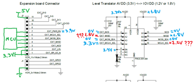

Dear Anne,
For the testing, I have paused in the middle of an SPI transaction, so that I can measure voltage values:
This is the diagram showing the connections in green. In blue, you can see the measured voltages which are as expected, and in red we have the values which don't make sense.
In addition, the jumper is in the 1.8V position. Measurements on SPI_I2C_N and LPn pads show 2.2V, which also differs from the expected values (1.8V).

The EXT_PWR_EN needs to be fed with the same voltage as the VIN pin as per the datasheet of the LDK130M12R LDO.
This means the EXT_PWR_EN should be 5V and not 3.3V.

Hello Anne,
EXT_PWR_EN is now connected to 5V, but everything else remains the same.
