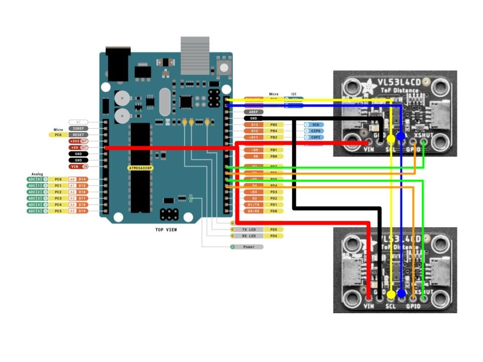

Running two Adafruit VL53L4CD with Arduino R4 WiFi
eclemmon
I've been trying to get two Adafruit VL53L4CD's to work without a multiplexer on my Arduino R4 WiFi, and am getting stuck after getting one reading. I'm largely drawing on the code discussed here, and have also changed up the bits that nh1628 discussed at the end of the thread so that it matched. I am not sure why it seemed to work for them, but not in my case:

I did some more snooping around and found that the units simply aren't having their I2C addresses changed, so I tried to manually change just a single unit (and leave the second off for the time being):
  DEV_I2C.begin();
  digitalWrite(xshut_pin_1, LOW);
  digitalWrite(xshut_pin_2, LOW);
  digitalWrite(xshut_pin_1, HIGH);
  sensor1.VL53L4CD_SetI2CAddress(sensor_1_address);
  sensor1.begin();
  sensor1.VL53L4CD_Off();
  sensor1.InitSensor();
  sensor1.VL53L4CD_SetRangeTiming(200, 0);
  sensor1.VL53L4CD_StartRanging();
And the sensor is just returning the default I2C address that the unit comes with (0x29).
What gives here? Am I doing something wrong? I tested this with an R3 Uno, and got the same results.
Wire diagram for reference:
Untitled-drawing

John_Kvam
Senior II
Once you've changed the address of the sensor, don't turn it off. It will revert to the default address.
To accomplish what you want ...
Put both sensors in reset by dropping the Xshut line - or the power I suppose.
Then bring the first one out of reset.
Change the address - and perhaps do the init.
Then bring the second one out of reset.
And change its address and do the init.
If this second sensor is the last one, you could just run without the address change, but I generally change the address of all the devices.
If either of the devices reboot - due to a power glitch or something - they will revert to the default address.
But the import bit is that if you drop the XShut or power them down, they will revert to the 0x29 default address.
- john

Hi John, thanks for the response. I'm still getting the same result even when I hard code the I2CAddress here—my I2C monitor is returning 0x29 as the address.
eclemmon
I dramatically simplified my code and wiring and am still getting no change to the I2C address.

John_Kvam
Senior II
Do your functions check for a return? There is a possibility that the I2C function failed to set the address.
If the device is booted and the I2C works, it really must work. It's only setting a register. So the 0x52 hits the bus, the 2-byte register address and then the one-byte new address.
So first thing is to verify the I2C is working. Read the deviceID. And example of how to do this is in VL53L4CD API you can download from ST.com.
But until you get this worked out, please check the completion status of the I2C read and write functions.
That has got to be the failure area.
- John
