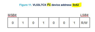

The problem is that I can’t initialise my sensors. When I keep the default I2C address for all the sensors, the 1st sensor tries to initialise forever without never returning any error or success code. When I try to initialise each sensor with a different address (0x54, 0x56, …), the init_sensor method returns an error value (value different from 0). I feel like the sensors are not detected at all by the Nucleo board…
Could anyone help me on what I am doing wrong here please?
Thanks a lot!
3 REPLIES 3
The chip is programmed to respond to a particular address. In this case it's 0x52. You don't get to pick what address you use.
This is what I did in the first place, I initialized the sensors without specifying any address in order to use the default one. But in this case, the code is "blocked" at the 1st sensor being initialized: no value (0 or different from 0) is never returned by init_sensor().
