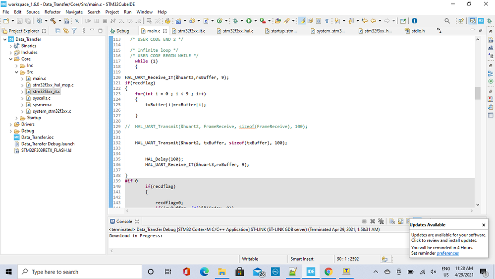

The sensor talk to stm using I2C? I Connected sensor as per datasheet using UART protocol using rx and tx lines.Do you mean to say it is something internally that changes it to i2c?The code i wrote is extremely simple.Getting data in interrupt mode,Raising a flag in callback function and use this flag in while loop0693W00000AMuw5QAD.png

TeslaDelorean is correct. Read the data sheet for this device.
Each 8 byte data frame starts with a 0x5959 which happens to be ascii YY, but the remaining bytes are binary. Either convert the binary to ascii before sending to Tera Term, or use a terminal emulator that provides for a hex display that is easier to interpret than garbage.
