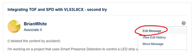

(For next time, you can edit your post here rather than reposting.)

Thanks for the quick reply and for the editing tip.
