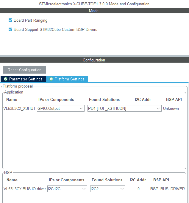

How to create the "Dev" used in ????? :
status = VL53LX_WaitDeviceBooted(Dev);
:loudly_crying_face:
Code from "STSW-IMG015" is using i2c object that I don't have since MX have link it to TOF ( and XSHUTDN GPIO too ).
I've tried but nothing works for me, each time = crash ...
I'm pretty sure my TOF device is waiting me somewhere in my project ... arrrgggghhhhhhhh ...

To be more precise : I have added&setup 2 packages in my project.
In my MX 's project >> Software Packs >> STmicroelectronics.X.CUBE.TOF1.3.0.0 Mode and Configuration I have :
☑�? Board Part Ranging
☑�? Board Support STM32Cube Custom BSP Drivers
Thanks for help.
