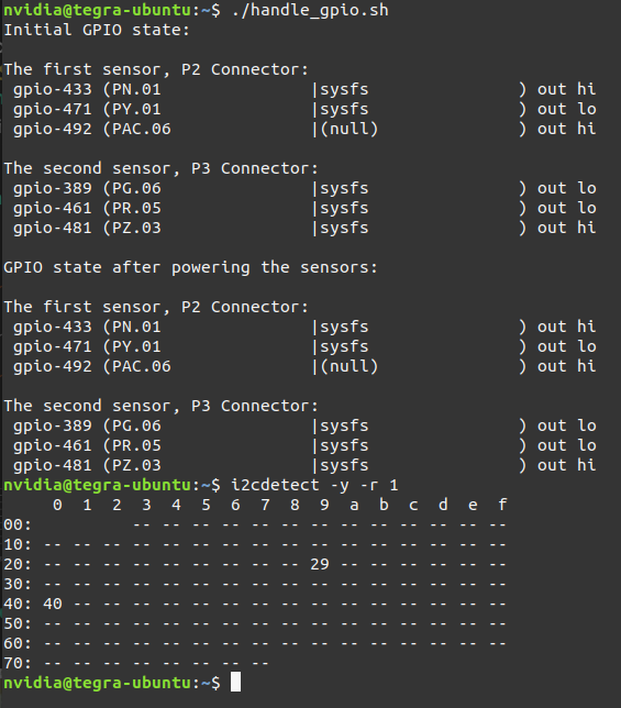

I wrote a small script to handle sensor connections and establish a connection with each sensor:

For P2 and P3 connectors, this solution works:
But, the connection wasn't established with sensors on P4 and P5 connectors.

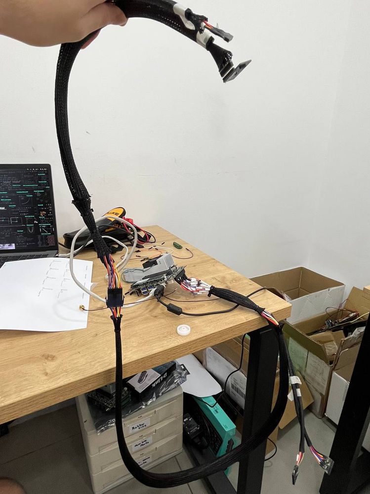

So, I decided to connect one sensor that works properly using jumpers, following the connector scheme for each P4, and P5 connection. And the connection was established only with jumpers according to the scheme, but the connection via cable connector didn't succeed (I checked all pins for continuity).
I guess the problem may be in the length of the cable.
Connectors P4 and P5 have a cable length of about 1.5 meters:
Please advise me on how to solve this issue and if there can be something else for a reason.

John E KVAM
You are exactly right. It's the cable length. And you are not the only one. 20 years ago, I had an unstable I2C desgin, and the trace length was about a foot. Six or seven years ago, I was debugging an ST cable of about 50cm. Worked fine as soon as I shortened the cable.
So you are not the first, and certainly will not be the last.
The I2C bus was invented to send one or two byte commands to chips during startup. And over the years it has changed to a full blown bus. Although not a very robust one.
NXP bought Phillips and they have a lot of documentation on tuning a bus. You need to evaluated the capacatance and size the pull-ups. It takes work and depends on the number of deviced on the bus, the bus length and even the size of the wire gets into it.
Shorting the wire is the best solution. Using two different busses will work too.
And if you want to prove that it's the bus length, get a scope and look at the lines. You will find that either the clock or the data line will be stuck low. And when not transmitting both these lines should be high.

Hi!
Thanks for the detailed reply and the brief story about the "erratic" i2c bus)
I also observed that if the P3 and P4 wires are very close to each other, there is noise in the signals.
I'll do the appropriate tests and keep you updated.
