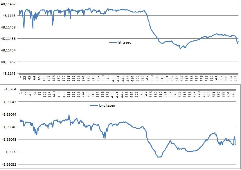

Is there any specific parameters to configure to acheive correct CEP?
Starting from default mode I found a CEP worst than some L1 only GNSS....despite I respect the 70x70mm ground plan for the antenna....
Many points are correct (but not more) but a few are awfull (more than 20m far away from position...)
Do you suggest any ceramic antenna?
Best regards
Mich

So with the GNSS on the car roof on a parking and a test on 15mn I have a CEP of 2.3m.
Do you have advices to improve this?
As you can see sudenly latitude and longitude changed despite the GNSS did not moved...
