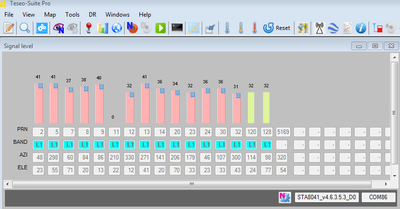

The teseo GNSS is outside, on the roof of the car.
I linked the Teseo GNSS to your Teseo-Suite Pro tool.
I requested the configuration with your Teseo Suite and the result is :
$$PSTMSETPAR,1227,0xbc0003d5*06
But as shown, your teseo GNSS can only see GPS satellites:
How is it possible that only GPS satellites are seen?
Is there any other configuration to check?

I attached the log file with the GSV messages.
Best regards.
