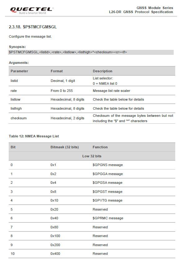

Hi, what is the function of the rate, list low, and list high parameters? I am trying to understand how to configure the message list, thanks0693W000007BKgCQAW.jpg

Rate is there to down-scale the message-list again the Fix-rate
But just one more question L26-DR GNSS is a Quectel module, which embeds a TeseoIII, therefore you should ask support to Quectel on the specific module and on what they did on the module.
