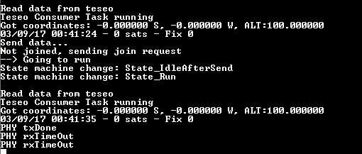

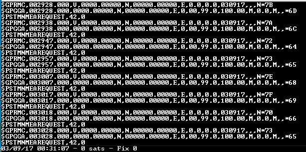

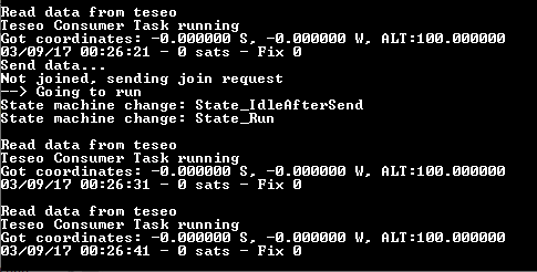

I was connecting to the PC using the USB-C cable provided in the kit and following the instructions in UM2541.
When I connect to Tera Term using the USB only at a Baud rate: 115200 I get data seen in the image attached.
When I connect to Tera Term over UART I see the data in a different format in the second image attached.
So based on this it is not getting any sats therefore co-ordinates are always 0,0,100
There is a sending joined request in the image below do I need to complete some additional tasks to enable geo-location
I just want to demonstrate the module finding sats and acquiring its location for now as I am hoping to use the Teseo LIV3F in a larger design we are working on.

Take care you have to use the evaluation board in open sky condition.
Is it the case?
Regards
Francesco

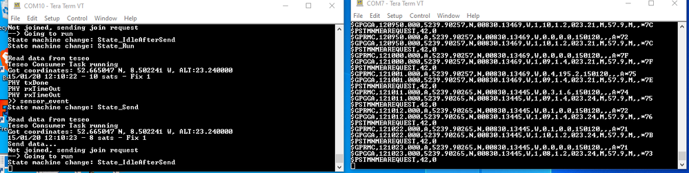

Hi Francesco,
I have sats streaming now that I am in an open sky condition.

Perfect!
Now it's working.
On teseo-Suite ... the  STEVAL-STRKT01 isn't designed to work with Teseo-Suite.
Let me clarify.
teseo-Suite assumes the teseo-3 (modules or chips) is in "Stream mode" this means Teseo3 continuously the NMEA message (without any Host command/request....)
In caser of  STEVAL-STRKT01, Teseo3 has been configured to provide message only on request.... in detail:
$PSTMNMEAREQUEST is sent by the Host (which asks 2 message)
$GPGGA and $GPRMC are the answer-message teseo3 sends.
IF you configure the Teseo-Suite COM as done on TeraTerm.... Teseo-Suite will be connecter but very few panel will works because teseo3 is providing only position data.... for example the ' View Monitor' panel shoule work (just shoews NMEA data) while the 'Signal Level' panel will not work for sure because the message it should print... it not sent at all by Teseo3)
Hope this helps
Regards
Francesco
