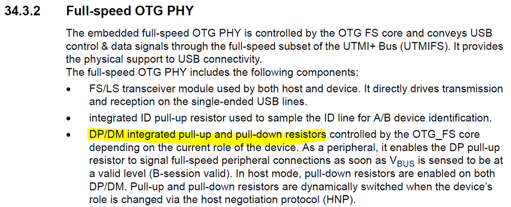

Does STM32F412 require the external USB termination resistor? The datasheet and manual don't indicate anything about it. Thanks
Mhonj.1
The STM32F412 has a built in pull resistors on the data lines. I'm sure it's in the reference manual.
You can also use this document to quickly check which series have integrated resistors:
https://www.st.com/resource/en/application_note/dm00296349-usb-hardware-and-pcb-guidelines-using-stm32-mcus-stmicroelectronics.pdf
