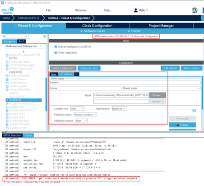

I'm trying to analyze my Keras model (converted from Keras) in STM32 X-CUBE-AI version 8.1.0. But it shows this error: TOOL ERROR: 'gbk' code can't decode byte 0xb8 in position 577:illegal multibyte sequence.
As shown in the picture.

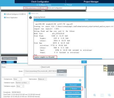

But I I'm trying to analyze in STM32 X-CUBE-AI version 7.3.0. It can be analyzed!!!

Upgrading STM32CubeMX to V6.10.0 can solve this bug.:beaming_face_with_smiling_eyes:The version I used before was was V6.9.2.
