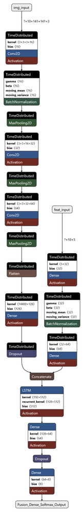

Attached are the neutron graphs for the .h5 model and the converted onnx model

But during analyzing i get the following error for the .h5 model (model input type: Keras, with STM32Cube.AI MCU runtime):
NOT IMPLEMENTED: Unsupported wrapped layer type: BatchNormalization
Also, if i skip the BatchNormalization the analyzing works, but my results when training the model are worse, but acceptable. The issue is still, that the model does not get optimized/quantized and i cannot find information why this is.It would net over 14Mib for activations, almost 8Mib for weights and over 490 million MACC.
During analyzing for the onnx model (model input type: ONNX, with STM32Cube.AI Neural-ART runtime):
INTERNAL ERROR: Found transpose model_CNN_Pool3_max_pooling2d_2_MaxPool__680 before {LSTM__280} with remapping (0, 2, 3, 1)
