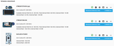

I tried your model with our development version and it is working as expected.
Could you please try to downgrade your op_set to see if the behavior change ?
For your information, with our development version:
