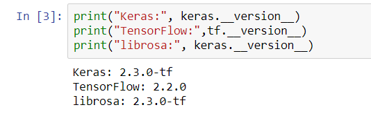

Laurent
Can you check the keras & tf version ?
In my environment I get ( you can see it from cell 3 of the jupyter notebook) :
try to align the versions and check
best regards
L.
Laurent
MSant.11
Keras: 2.6.0
TensorFlow: 2.6.0
librosa: 2.6.0
Laurent
then maybe the versions are not compatible with one another, you should install older versions it should work . this pack was developed ages ago ...
