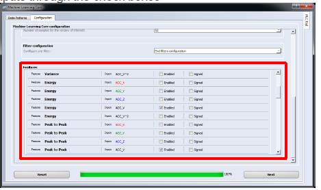

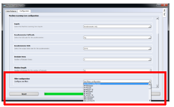

to detail Winfred,s answer, please consider that in Unico 9.0.0.0. one or more computation blocks can be configured for the preliminary MLC procedure definition:
  • Filters configuration:
    • you can add one or more filters, on the desired input, the tool will automatically ask the necessary filter coefficients to implement it
    • then you have to choose “End filters configuration�? and click “Next�? to exit
  • Features configuration: you can select the features on the desired inputs through the check boxes

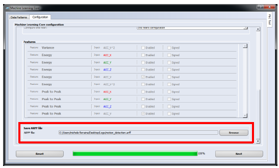

After the preliminary filter and feature configurations, the GUI will generate an ARFF file, which contains all the features computed on the input data, and the expected results and will be the input for the ML tool (e.g. Weka)0690X000009Z2kXQAS.png

RSelt
Eleon,
I do not get the "Save ARFF File" selection (as can be seen in the associated screenshot). If I "next" I get another "Features" selection. I just "next"ed 100 times and never got a save option. I thought that it may be a window sizing issue (hidden under the Features" selection), but the window will not resize. As can be seen by the scroll bars, the two windows are scrolled all the way to the bottom.

Eleon BORLINI
Hi Rick, I think you should enable at least one feature to proceed. Regards
RSelt
Eleon, I have enabled ACC_Z, Mean, signed. In the previous screenshot you can see this feature above the current selection feature. ...... when you "Next" you get another Feature Entry selection option but no ARFF file save option.
Eleon BORLINI
​Ok, but did you mark "Enable" or "Signed"? Previous steps are only the following:
  • Data pattern loading
  • Below configuration settings
Regards
RSelt
Eleon,
Solved. I had selected feature: ACC_Z, Mean, signed.... but not checked the "Enable" box (as per your prior email).
