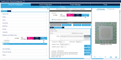

I am trying to create an STM32Cube.AI application using X-Cube-AI. I am following the documentation under Content 6. I trained my own model and configure the .ioc file as shown below. I wanted to get input from the ADC and feed directly into the model to perform classification. I am using the latest X-Cube-AI version 8.1.0.

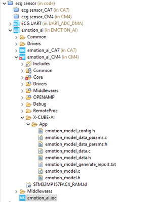

Under my X-Cube-AI folder, this is what I got:
