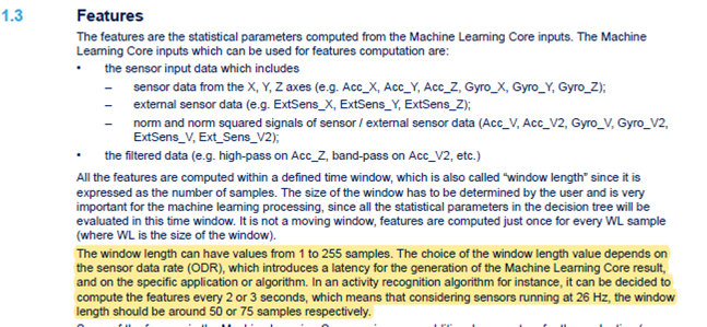

Hi @EC.2​ ,
please have a look to this part of the Application note, section 1.4.
0693W00000FDtxiQAD.pngFor better understanding, it might be useful to give this example:
Window length is expressed as number of samples. The time window can be obtained by dividing the number of samples by the data rate chosen for MLC (MLC_ODR):
    Time window = Window length / MLC_ODR
For instance, selecting 104 samples for window length and 104 Hz for MLC data rate, the obtained time window will be:
    Time window = 104 samples / 104 Hz = 1 second
So, not all the widows length values are the best fit.
See also this other section, the highlighted part:

Hi @EC.2​ ,
The feature value depends upon the window length and upon the MLC_ODR, and these parameters are chosen by the user. You can refer to the LSM6DSOX: Machine Learning Core Application note AN5259, p.9:
All the features are computed within a defined time window, which is also called “window length�? since it is expressed as the number of samples. The size of the window has to be determined by the user and is very important for the machine learning processing, since all the statistical parameters in the decision tree will be evaluated in this time window. It is not a moving window, features are computed just once for every WL sample (where WL is the size of the window).
The window length can have values from 1 to 255 samples. The choice of the window length value depends on the sensor data rate (ODR), which introduces a latency for the generation of the Machine Learning Core result, and on the specific application or algorithm. In an activity recognition algorithm for instance, it can be decided to compute the features every 2 or 3 seconds, which means that considering sensors running at 26 Hz, the window length should be around 50 or 75 samples respectively.
So, you are right, if you change the window / ODR settings you might get different outputs. You have to chose the parameter values that fit at most your application target.

Hi @EC.2​ ,
