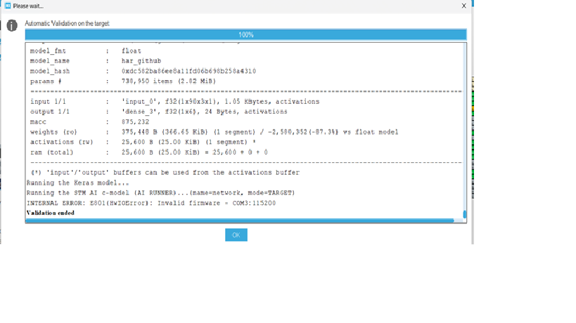

I have deployed the example of HAR on the STM32F407 Discovery board. I have followed all the steps in the 'Getting Started with X-CUBE-AI Expansion Package for Artificial Intelligence (AI).' In the end, the validation was completed as shown in the attached figure. Now, I would like to test my model with new inputs and hope to find the output, but I don't know how to do that. I couldn't find any documentation or videos showing how to do this.
2024-07-23 4:12 AM
You can refer to the embedded documentation (Help->X-Cube-AI Documentation in STM32CubeMX) in the FAQ there is a chapter on how to create the input/output file for the validation
The documentation is typically here ~/STM32Cube/Repository/Packs/STMicroelectronics/X-CUBE-AI/9.0.0/Documentation/faq_validation.html
