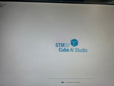

I have recently installed and launched stm32cubeai studio latest version and it appears to be hung at launch screen with progress bar in motion.
I have tried to close this from task window and tried uninstalling and installing it but still same issue.
restarted the pc as well. What could be the issue.
I have still 10 gb of hard disc space left.

Could you share the logs, available in C:\users\<username>\.stm32cubeaistudio\logs ?

I have seen a similar problem due to proxy settings and environment variables. We are investing internally but you issue may be similar.

Any update on this. I  suspect if it is my windows pc issue only?

The next release should be next week, and we are adding proxy setting support.
I think it would be great if you could wait for the next release and test some proxy configurations
