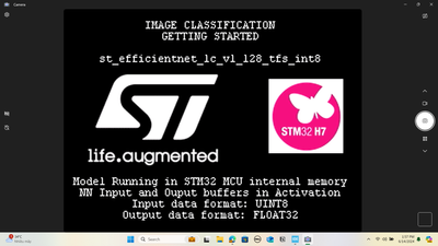

Hello , I have a problem when trying image classification with STM32H743ZI2+ B Cam Omv,

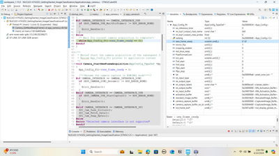

My generated code from ST_Model _Zoo build with Camera DCMI Mode + USB Display is oke, but afer i flash, My display stop here , seems like it can't get new frame and stay at function while infinitie becausce new frame ==0,
I want to ask how to capture image and make it run like example
