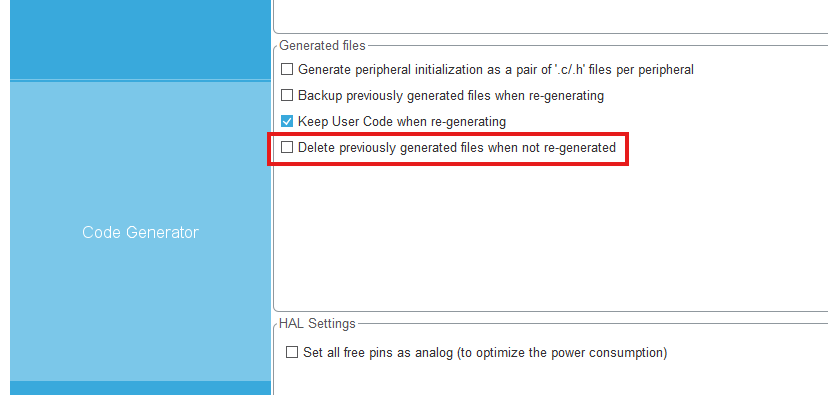

Hello @chanchal94 ,
When regenerating, please uncheck this box to see if it corrects your issue
Best regards,
Yanis
I tried unchecking the box as suggested by you, @hamitiya, but the issue still persists. The problem remains the same — corrupted files and the path issue that I explained earlier in detail.
