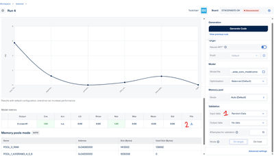

As of today, you can download STM32Cube AI Studio (that replace X Cube AI):
https://community.st.com/t5/edge-ai/meet-stm32cube-ai-studio-the-new-go-to-tool-for-embedded-ai/td-p/880369
With this you can import input data as npz file or csv file (1) and get the output (2):

For your third question, if you do a validate, you get the confusion matrix in the CLI but I am pretty sure you have the real output in the generated files after the command in core. (in st_ai_output or st_ai_ws).
If you use the STM32Cube AI Studio, you directly have them as shown earlier.
