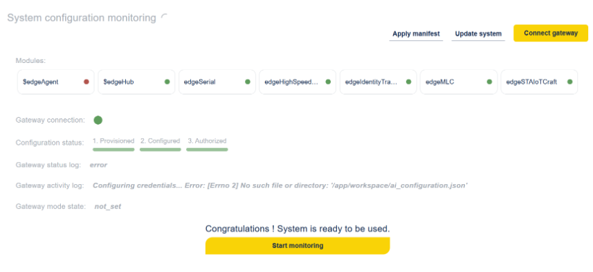

Hello I am trying to complete my first IOT system deployment on STAIOT Craft using a STEVAL WINBX1 as the target. I have set up the project, created a dataset and model and am following the workflow to set up an E2E system using ST Azure. I get all the way through the workflow and it looks like its going to be successful but at the last step it errors (as below) and so i cannot use the dataset nor inference tabs on the subsequent page.
Setting inference mode... Error: [Errno 2] No such file or directory: '/app/workspace/ai_configuration.json'
I have tried to do this using different SD cards, on Edge, on Chrome, making sure pop ups, redirects and downloads are all set in the browser.

Hello Davide, and many thanks for your detailed reply. I have re-run the as you suggest by starting a completely fresh project and i note when i log in that the Web app seems to have been updated to a later version?

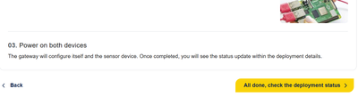

I followed the wizard on the website and everything seems to work as expected up to configuring the gateway which is where i hit a roadblock (This is happening earlier than the previous webapp version). I can flash the sensor device successfully (it shows a greenbanner confirming this) and i flash the pi with the gateway firmware (and i can log into the gateway and it appears to boot successfully). So i reach the stage of the wizard to power up both devices and check the deployment status

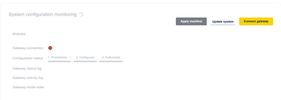

When I hit the yellow button i get the following screen and it doesnt appear to progress further than this status no matter how long i leave it (the circle keeps revolving and i have left it for hours).
In the previous webapp version i could get the modules to load and the stages to progress until the configuration status showed all green lights)
If i try and connect to the gateway using the yellow button i get the follwing error in the tab that is opened (the site address has a warning saying not secure in both edge and chrome)

I have checked with the team, and apparently only few updates at UI side of the datalogging panel have been made in between September 21st (your first post) and October 7th (your last post), nothing related to functionalities, though.
Concerning your current issue, the red LED at the Gateway connection state makes me think that probably the gateway is not reachable by our back-end, for some reason. Let me suggest a checklist that you can easily verify:
- The SD card has to be flashed with the pre-canned image provided and the "staiotcraft_config.ini" file has to be generated and downloaded from the web portal and copied into the SD card;
- The gateway has to be connected to the Internet either via WiFi or ethernet; please verify you can ping 8.8.8.8, for instance, from the terminal (credentials to log in are: "staiotcraft"/"staiotcraft").
Please confirm the abovementioned points, thank you.
Moreover, please note that the Connect gateway button works only in case the gateway and the host are on the same network and the gateway is in connected state, that's why you get the error. To improve the UX, we will disable the button in case the gateway is not connected, in the next releases. Thank you for signaling this issue.
The whole configuration procedure is described in our documentation section here: Step-by-step IoT system setup; you will find also a Troubleshooting chapter at the bottom of the page, which is particularly relevant in case you are using a Raspberry Pi 4, for which a powered USB hub is suggested when connecting boards, keyboard, mouse, and display peripherals.
