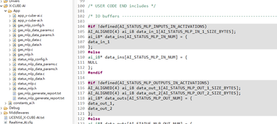

Hi, Does the model deployed on the STM32H743 need to be quantized first like the n6, or can floating-point types be deployed directly? Additionally: After the deployment is completed, how should I pass the data to the model for inference and obtain the inference results? If using serial communication for data transmission, do I need to additionally configure the serial port and clock in CubeMX? Is there example code for specifically passing input samples via serial communication? Thanks!
But I want to customize my input and output the result through the serial port. How should I do this?Thanks!

Hello! I am trying to use the above code now, but the serial port is not returning any data. Moreover, when I use code that only configures the serial port, the serial port can send and receive data normally. However, once I add x-cube AI, it fails to return any content. Could you guide me on how to resolve this issue? Thank you!
Stone_chan
HI , llcc
Please check settings , some variables are not automatically generated , like IO buffers variables
Thank you! The problem has been resolved; it appears to have been an issue with the clock configuration.
