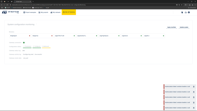

I'm trying the STAIoT Craft platform and I'm having issues trying out the IoT Systems.
So far I've tried cloning and deploying two samples:
  • Smart Asset Tracking
  • Human Activity Recognition
This is my setup:
  • Google Chrome Version 130.0.6723.1 18 (Official Build) (64-bit)
  • SensorTileBox.Pro (with SD Card)
  • Rapsberry Model 4B 8GB RAM (32 GB SD Card for OS)
  • edge_gateway_production_20241107_1_2_0.img
  • Wi-Fi
I cloned the sample projects from the STAIoT Craft Homepage and just tried them out. I followed the instructions for deployment (flashing the sensortile, downloading Raspberry OS and configurations...) as described by the step-by-step procedure.

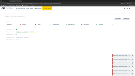

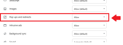

This is a screenshot of the issue with the Smart Asset Tracking sample:
Immagine1.pngI tried clicking on "Apply Manifest" but it didn't change the results:
 Just to be sure, I tried the Human Activity Recognition sample, with the same result:
The only thing that is not clear to me (but I tried both ways) is if SensorTile and Raspberry have to be ON before I connect them with the USB Cable (or if this makes any difference).
Let me know if there is other information I can provide to debug this.
Thank you,
Claudio

Hi Claudio,

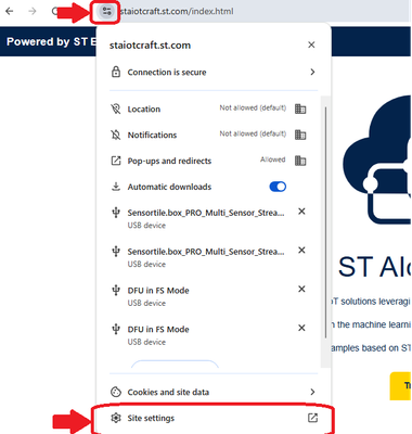

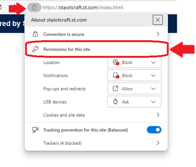

it seems your browser is preventing ST AIoT Craft web app opening a browser tab automatically. Please double check your browser settings: Pop-ups and redirects option must be set to Allow.
To resolve, keeping ST AIoT Craft web app opened, please, follow below steps:
  1. Click button placed on left side of URL bar
  2. Click "Site settings" (in case of Chrome browser - Fig.1) or "Permission for this site" (in case of Edge browser - Fig.2)
  3. Look for Pop-ups and redirects option and set Allow (Fig.3)
  4. Finally, wait few seconds or refresh the page (if it takes long) to complete successfully the IoT System configuration.
Hope it might help. Don't hesitate to ask if the issue persists.

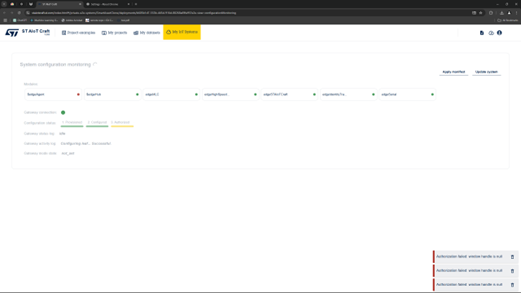

Hi, thanks for the fast reply and sorry for the low quality images!
Sure, that solved part of the issue (my bad, but also: I wasn't seeing any pop-up asking to allow redirects)

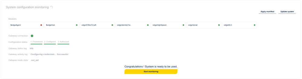

Now, this is where I get after authorizing:
Is "edgeAgent" being red an issue?
Also, unless I go to "Monitor" and click on "Start Inferencing" the leaf is shown as "Disconnected".
Last week I had an issue where the "monitor" graph wasn't updating properly.
Anyway, I was on a different browser where redirect are active by default and on an older version of the gateway OS (20241030_1_2_0_rc1).
Also: it was telling I was able to start monitoring even though "gateway activity log" advertised an issue.
By the way, everything seems to work now with the Human Activity Sample, I will try the other sample tomorrow and eventually let you know.

Hi Claudio, sorry for the late response.
Nope, it is not an issue at all.
That's correct as well. Gateway connects the leaf device to the cloud once you configure the overall system in Inference mode.
