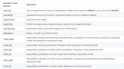

Just to put some context, the idea behind model zoo is to configurate the user_config.yaml to do a lot of things:
So the idea is to edit the user_config.yaml and use the python script stm32ai_main.py, not to use the deploy.py.

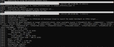

Hi Julian, thanks a lot for your very detailed and helpful reply. It looks like quantization is enabled by default in stm32ai_main.py, so is the benchmarking.
I believe that the benchmarking is done on the cloud, judging by this line in "stm32ai_main.py" and the "credentials" requirement?
benchmark(cfg=cfg, model_path_to_benchmark=quantized_model_path, credentials=credentials, custom_objects=IC_CUSTOM_OBJECTS)
I'm still a bit confused about how to deploy the code onto my dev board. Is there a binary output resulting from "stm32ai_main.py" that I can use to program the kit? In which step of the script does the kit gets flashed?

Based on your CMD screenshot, your yaml is using an operation mode that at least contains quantization and benchmarking.

As for the deployment, if the operation mode contains the deployment (so deployment or chain_qd, see the tab in my first post), if your board is plugged, a basic application and your model will be deployed on your board.
