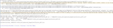

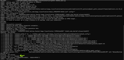

Nov 11, 2024 3:18 AM UTC
Hi @Julian E. ,
I've tried downloading a new version of the stm32 model zoo and trying the deployment again both with the 'deployment.py' file and through STMCubeIDE. I am not getting the previous LCD fatal error but rather these warnings. I have tried using STMCube version 1.13, 1.10, and 1.16 but to no avail.
C:/Users/harth/Downloads/stm32aimodelzoo/stm32ai_application_code/image_classification/Application/STM32H747I-DISCO/Src/CM7/main.c:236:3: warning: 'memset' forming offset [153600, 153631] is out of the bounds [0, 153600] of object 'CapturedImage_Buffer' with type 'uint8_t[153600]' {aka 'unsigned char[153600]'} [-Warray-bounds]
c:\st\stm32cubeide_1.10.1\stm32cubeide\plugins\com.st.stm32cube.ide.mcu.externaltools.gnu-tools-for-stm32.10.3-2021.10.win32_1.0.0.202111181127\tools\arm-none-eabi\bin\ld.exe: warning: section `.bss' type changed to PROGBITS

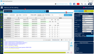

Julian E.
Julian E.Best answer
Nov 13, 2024 2:31 PM UTC
Hello @rt_ecyhg1 ,
I could not reproduce your issue.
We will try something, download the .zip file attached which contains the cm7.elf.
Open STM32CubeProgrammer:
  1. connect your board
  2. load the elf file
  3. Click download it. Wait until its finished
  4. Then disconnect and then unplug and plug the board.
 Does it work? If not there is an hardware issue.
If it works, something is wrong with what you did, so here is the exact process:
First, make sure you have this exact hardware:
Then use a micro usb to usb A cable (in other context, I've seen issue with usb c cables). Make sure your cable is data.
Plug and unplug your camera (maybe it is not well pluged).
Then with model zoo
Once everything done:
Do you still get your Flag error ?
Do you still get the strange LCD display?
Do you have another evaluation board and camera?
If it still does not work, we will need the help of dev from the model zoo and they are not so much available at the moment, so you may have to wait until mid december...
Have a good day
Julian
​In order to give better visibility on the answered topics, please click on 'Accept as Solution' on the reply which solved your issue or answered your question.
