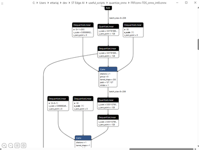

Hello @SR1218,
Your model is already very small. When quantizing the model in QDQ format (which is what we support, and the dev cloud is doing), it adds new layers quantize and dequatize that can help reducing the size of big models.
But in the case of small models, the weight of these multiples new layers increases more the size of the model than what you gain in terms of weights compression.
Non quantize model 53kb -> QDQ model 62kb.
In your case it even creates a bug when using the ST Edge AI Core (that converts the model to C, behing the dev cloud and X Cube AI). But as I explained, even if there was no bug, it would still not help you...
