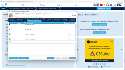

Hi everyone,
I'm having trouble generating a project to run an AI model on the Nucleo-N657X0-Q board.
I open STM32CubeMX version 6.14.1, select the board, choose "Secured Application", and then when I select the X-CUBE-AI package, it asks for the ZIP file available here:
https://www.st.com/en/development-tools/stedgeai-core.html?ecmp=tt9470_gl_link_feb2019&rt=db&id=DB4255
I download it, choose to use X-CUBE-AI in the Application domain, and when I try to select the ONNX model, it asks whether I want to optimize peripherals and clock. At this point, whether I click "Yes" or "No", CubeMX freezes indefinitely.
I’ve already tried using CubeMX version 6.13 as well, but it didn’t help.
My suspicion is that the problem might be related to the version of ST Edge AI. Version 2.1 on the ST Edge AI Developer Cloud throws an error during optimization (although maybe it's unrelated). Also, when selecting the package ZIP file, the dialog only shows folders, not ZIP files. I have to manually navigate to the directory and enter the ZIP file name in the dialog box to select it. However, I can't try older versions as I can't download them from the website.
Is there any way to fix this issue ?

2025-05-21 5:19 AM
Hello @Dresult,
I don't really understand why it asks for the zip when you select X Cube AI?
The version 10.1.0 of X Cube AI is out, do you have it installed? Maybe, if you only have the 10.0.0 it creates strange behavior?
Could you try to install the version 10.1.0 from the main page of CubeMX and try again? I cannot reproduce your behavior.
You may have to try uninstalling every version of the X Cube AI inside CubeMX to see if it helps.
Have a good day
Julian
2025-05-21 8:14 AM - edited 2025-05-22 12:08 AM
Hi @Julian E., thank you very much for your reply!
I've updated to version 10.1.0, however, if I make a new project and try to use X-CUBE-AI I still get CubeMX freezing. A temporary solution I am exploiting is using the XIP template from this GitHub repository: https://github.com/stm32-hotspot/STM32N6_FSBL_Modes/tree/main
With that, when I am asked if I want to set the clock and peripherals for improved peformance everything works smoothly.
On the other hand, there is an issue when trying to compile for the Neural-ART: when I try to analyze the model, I get an error with the following output:
