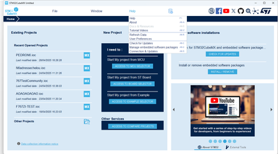

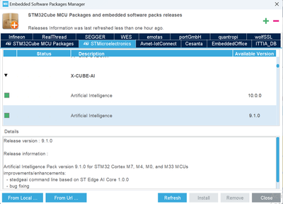

Hello @VinaySankar,
You probably have to update CubeMX:
Click Help > Check for Update
Or you can install the update using a .zip.
Click Install package as you did, then from local and select the zip from the X Cube AI 10.1.0 that you can download here:
https://www.st.com/en/embedded-software/x-cube-ai.html

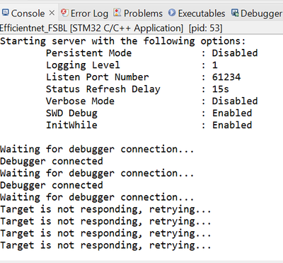

May 26, 2025 12:28 PM UTC
Hello
Also, while working with Nucleo using a "Discovery-kit" project, be careful of the following things, as Nucleo boards do not have an external SRAM connected to XSPI1:
  • Do not try to "memory-map" the memory connected to XSPI1 (i.e. do not memory-map external ram)
    • -> Do not try to read/write external RAM !
  • If XSPI1 is not initialized/clocked, do not try to configure the RISAF associated to it (RISAF11)
Both actions may result in the behaviour you are observing.

Jun 16, 2025 8:14 AM UTC
Hello
Sorry, i was somewhere else.
On my side, if i test your project, everything fails at line MX_ICACHE_Init();
Are you sure you need to use ICACHE (Texture Cache)  ?
If you want to use instruction cache, this is something different (look at the CPU configs in MX).
Could you try and remove this IP of your configuration if you don't use it (or clock it correctly) and tell me if it fixes some of your issues ?
