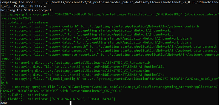

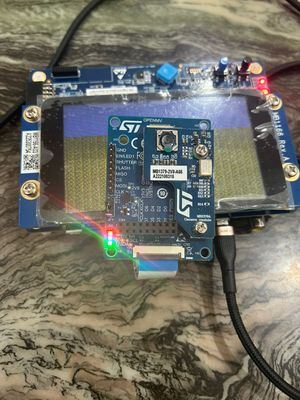

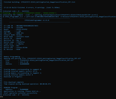

Although the CMD window indicates that the model is deployed successfully (figure 1), the LCD screen on the board remains blank (figure 2). This issue persists despite the fact that there are no error warnings in the CMD window.

I have tested with a new camera module the problem is with camera module.

I have recently trying to troubleshoot the problem by changing the debug from False to True to view the deploy process. At the beginning I noticed that there are 9 warnings, and I try to solve all the 9 warnings. However, after solving the 9 warnings the code still not working.

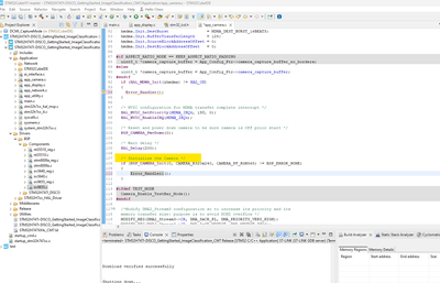

Just an update, after testing all the code to find the error using blue LED. I have found that the error is with initialize the camera module. After checking the error code is BSP_ERROR_UNKNOWN_COMPONENT based on STM32H747I_discovery_errno.h.
chew
