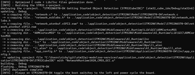

(st_zoo) PS C:\Users\ricky\git\stm32ai-modelzoo-services\object_detection> python stm32ai_main.py --config-path ./src/config_file_examples/ --config-name deployment_n6_ssd_mobilenet_v2_fpnlite_config.yaml

[INFO] : Building the STM32 c-project..
deploying the c-project.. "STM32N6570-DK Getting Started Object Detection (STM32CubeIDE)" (stm32_cube_ide/Debug/stm32n6)
updating.. Debug
 -> s:copying file.. "network.c" to ..\application_code\object_detection\STM32N6\Model\STM32N6570-DK\network.c
 -> s:copying file.. "network_ecblobs.h" to ..\application_code\object_detection\STM32N6\Model\STM32N6570-DK\network_ecblobs.h
 -> s:copying file.. "network_atonbuf.xSPI2.raw" to ..\application_code\object_detection\STM32N6\Model\STM32N6570-DK\network_atonbuf.xSPI2.raw
 -> s:removing dir.. ..\application_code\object_detection\STM32N6\Middlewares\AI_Runtime\Lib\GCC\ARMCortexM55
 -> s:copying dir.. "ARMCortexM55" to ..\application_code\object_detection\STM32N6\Middlewares\AI_Runtime\Lib\GCC\ARMCortexM55
 -> s:removing dir.. ..\application_code\object_detection\STM32N6\Middlewares\AI_Runtime\Inc
 -> s:copying dir.. "Inc" to ..\application_code\object_detection\STM32N6\Middlewares\AI_Runtime\Inc
 -> s:removing dir.. ..\application_code\object_detection\STM32N6\Middlewares\AI_Runtime\Npu\ll_aton
 -> s:copying dir.. "ll_aton" to ..\application_code\object_detection\STM32N6\Middlewares\AI_Runtime\Npu\ll_aton
 -> u:copying file.. "app_config.h" to ..\application_code\object_detection\STM32N6\Application\STM32N6570-DK\Inc\app_config.h
 -> updating cproject file "C:\Users\ricky\git\stm32ai-modelzoo-services\application_code\object_detection\STM32N6\Application\STM32N6570-DK\STM32CubeIDE" with "NetworkRuntime1020_CM55_GCC.a"
building.. Debug
flashing.. Debug STM32N6570-DK
Board programming failed: ""

It seems that model compiling succeeded but failed when flashing.

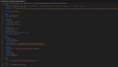

And this is the YAML file I edited:
Furthermore, example binaries in stm32ai-modelzoo-services/application_code/ works fine via CubeProgrammer, but failed when I run model-zoo-service python script.
How can I deal with the issue?
