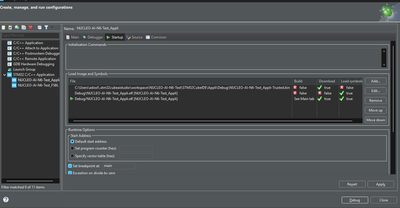

I am running into a persistent debugging issue with a generated STM32Cube AI Studio application on the NUCLEO-N657 board. The debugger seems to drop the connection when transitioning from the "FSBL" to the main application "Appli" , and subsequently locks up.

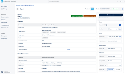

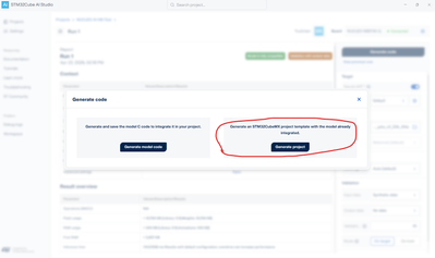

Note: The code is generated properly from STM32Cube AI Studio, and the model .hex file is downloaded successfully to the NUCLEO board:
The Issue:
  1. During the first time debugging the program, it starts correctly.
  2. I run the "FSBL" application, and it executes properly.
  3. As soon as the execution jumps from "FSBL" to "Appli", the IDE throws a "Target is not responding" error.
  4. On any subsequent attempts to debug, it does not work at all and throws the error shown in the attached image.
     Console:
    STMicroelectronics ST-LINK GDB server. Version 7.13.0
    Copyright (c) 2026, STMicroelectronics. All rights reserved.
    Starting server with the following options:
    Persistent Mode : Disabled
    Logging Level : 1
    Listen Port Number : 61234
    Status Refresh Delay : 15s
    Verbose Mode : Disabled
    SWD Debug : Enabled
    InitWhile : Enabled
    Waiting for debugger connection...
    Debugger connected
    Debugger connected
    Target is not responding, retrying...
    Shutting down...
What I've Tried:
I closely followed the steps outlined in this ST Community article for handling the N657 debugging process, but the issue persists:
How to debug STM32N6 using STM32CubeIDE
These are my configurations:
Build Steps for both the "FSBL" and "Appli" Applications:
"cd "${ProjDirPath}/Debug" && echo y | "C:\Program Files\STMicroelectronics\STM32Cube\STM32CubeProgrammer\bin\STM32_SigningTool_CLI.exe" -bin "${ProjName}.bin" -nk -of 0x80000000 -t fsbl -o "${ProjName}-Trusted.bin" -hv 2.3 -dump "${ProjName}-Trusted.bin" -align"
Has anyone experienced this specific loss of debug connection during the FSBL-to-Application handoff on the N6? Any advice on debugger configuration adjustments or how to recover the target when it gets into this unresponsive state would be greatly appreciated.
Thank you!
