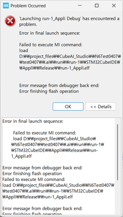

Student_0726
Hi @Julian E.,
Thank you for your reply. Apologies for the delayed response; I was taking some time to test things out in AI Studio.
After switching to AI Studio, I encountered an issue when clicking "Generate project" (please refer to the attached photo). I suspect this might be related to the External Memory loader settings, but it seems I cannot manually modify the .ioc file and regenerate the code to fix it.

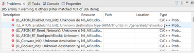

Because of this, I tried using "Generate model Code" with different configurations. In the resulting project, the compiler couldn't read app.x-cube-ai.c or network.c when they were placed in the external project folder (outside of Appli). To address this, I moved the App and generated folders inside the Appli folder and tried building again.
However, this resulted in an obscure error that makes it hard to pinpoint what went wrong: (LL_Arithacc_Init): Unknown destination type (ARM/Thumb). For your information, I have already configured the preprocessor and path settings.

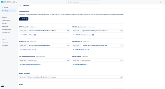

Hi @Student_0726,
Regarding the recommended versions, you can find them in the setting part of CubeAI Studio:
For the issue that you are facing, I am looking for answers internally.
Have a good day,
Julian
hamitiya
Unknown destination type (ARM/Thumb) suggest you may have a wrong version of GCC, or some compilation defines are not well set. Could you please verify that you are correctly using the one delivered with STM32CubeIDE while compiling ?
Best regards,
Yanis
Hello, @hamitiya
I wanted to let you know that this issue had been resolved. I was able to fix it while transitioning from X-CUBE-AI to Cube AI Studio with following various tutorials available here in this community.
Looking back, the previous error seems to have been a combination of several complex issues. It happened mainly because I had configured the settings in almost the same way as I would for internal Flash and standard CPU operations.
This community has been an incredible help to me. Thank you so much!
Thank you so much for sharing your insights.
Have a good day!
